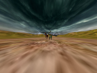

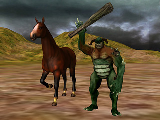

The transition effect should look like the following illustrations. The camera looks like it is moving but it is actually the result of changing the lens focal length.
