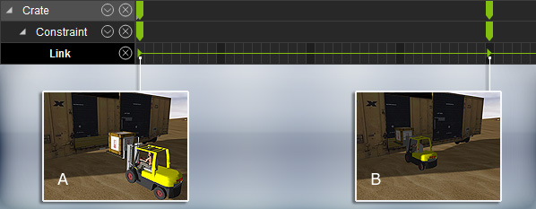

Setting keys on the Link track can make an Actor, Prop, Camera or Spotlight/Point Light link to a target at one point in time and then link to another target or unlink at another point in time. Thus the transition of an Actor, Prop, Camera, Spotlight/Point Light comes from the target's moving and rotating animation even though they may or may not be static. Please refer to the Link section for more information.
  1. Pick the crate and go to the desired frame to link it to the forklift.
  2. In the Modify panel, scroll to the Linkage section.
  3. Click the Pick Target button and click on the forklift. You may optionally align the crate to the forklift if its position is not adequate.
  4. Go to another frame, click the Pick Target button again, and then click on the train as the new target.
  5. The crate will be brought away by the train afterward.
A: Link the crate to the forklift
B: Link the crate to the train
