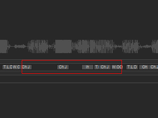

  3. Check out the timeline, find the Viseme track under the character. You will see a lot of visemes are automatically added into the Lips sub track.
  4. Play back to view the result, you will find the mouth movements may sometimes be jumpy, which is caused by the intensively clustered visemes.

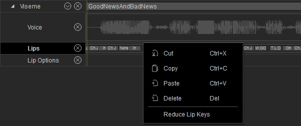

  1. On the Lips track, right click in the empty space to show the right-click menu.

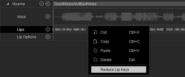

  2. Click on the Reduce Lip Keys command.

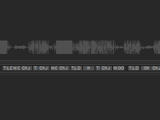

  3. The redundant lip keys included within the clip in the track will be hidden.
  4. Play back and the jumpy issue will be solved.
