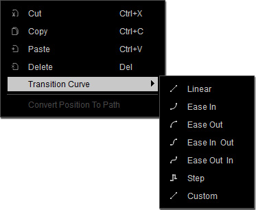

Set the Transition Curve
  1. In the target track of the timeline, set two keys (take the Transform track as an example).
  2. Right-click on the Later one. Select an item from the Transition Curve entry in the menu.
  3. The transition curve will then be generated between these two keys only.
Transition Curves

  4. Right-click on the later clip in the Motion track of the character.
  5. In the right-click menu, select the Transition Curve entry and pick any one of the effects.

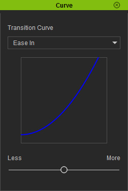

If you need more dramatic transition results, then you may use the Custom feature provided in the pop-up menu to adjust the steep of the transition curves.
  1. Right-click on the Later key or clip. Select Transition Curve >> Custom.
  2. Select a curve type from the Transition Curve drop-down list.
  3. Drag the slider to increase or decrease the variation of the curve. Note: When you decrease to the left-most side, the curve will be very similar to the linear curve.
    Less dramatic
    More dramatic
    Dramatized transition
    (Ease In)
