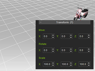

This feature is designed especially for the Transform track. Click the Reset (Zero Out) button in the the object attribute tab >> Transform section to add a transform key to neutralize the Transform effect of the previous keys. The transform data of the prop when it is modeled is retrieved and reset as the zero key.
The Reset to Zero feature is used to resume the move course of an actor/iProp after you add transform keys to it.
Meanwhile, when you are modifying the transform data and you are not satisfied with the result, you may also click this button to neutralize the data in the key and start all over again.

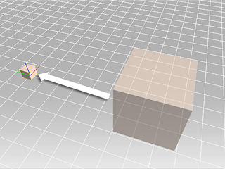

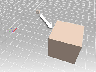

Reset to Zero - Regular Props

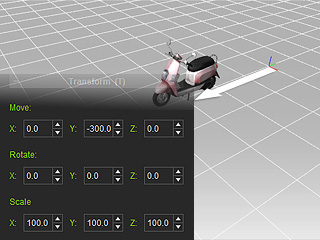

  1. Apply one regular prop and open its Transform track. The current transform data is added into the first frame in the track.
  1. Go to desired frame, add one key by moving, rotating or scaling the object.
  2. If you are not satisfied with the result and you want to reset the data, you may either:
    Adjust the transform again in the same frame.
  1. Go to another frame later than the key added in step 3. Click the Reset (Zero Out) button. iClone will then add a neutral key to cancel the effect of previous keys.

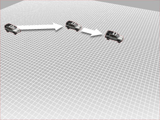

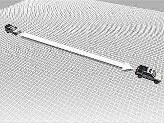

  1. In the timeline, apply a motion clip to the Animation track and open the Transform track.
  1. Go to the desired frame, and set one Transform key to tune the transform data which effects the motion.
  • The original moving path of the iProp.
  • Moving animation is saved in the
    Animation track.
  • A transform key (offset along the X axis)
    is added.
  • The path is modified by the transform key.

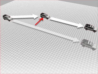

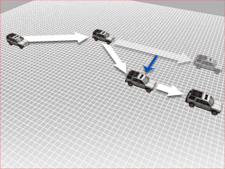

    1. If you are not satisfied with the result and you want to reset the data, you may either:
    2. Go to another frame. Click the Reset (Zero Out) button. iClone will then add a neutral key to cancel the effect of all the previous keys in the track.
  • When the car moves to the location
    as shown in the illustration, press the
  • A new Reset (Zero Out) key neutralizing
    the prior effect is then added.
  • The path is back to the original one.

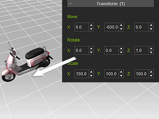

  • Formula: Transform in Move Clip and Transform Data
    The transform values in the Modify Panel can be described by the following formula:
    Transform by Move Clip (Animation Track) + Transform Key (Transform Track) = Transform Values (Modify Panel).

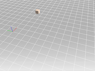

    Initial Position
    Set a Transform Key.
    Use the Move Command to move the iProp.
    The Transform Data is modified following
    the formula above.
