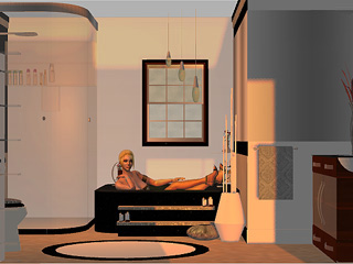

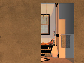

Setting the Near Clipping Plane Value
If your actor is indoor, the wall of the room will always hinder the view. You may use the Near Clipping Plane to filter out the objects within this distance.
  1. Go to the camera modify panel.
  2. In the Camera section, click the up arrow of the Near Clipping Plane.
  3. Near Clipping Plane = 0
    Near Clipping Plane = 40

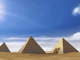

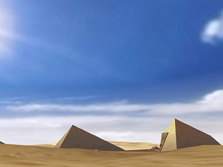

Setting the Far Clipping Plane Value
If your Terrain is so wide that it is beyond the camera's rendering range, you may adjust this value to solve this issue.
  2. In the Camera section, click the up arrow of the Far Clipping Plane.
  3. Far Clipping Plane = 9999
    Far Clipping Plane = 12000
