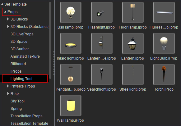

In the Light Tool library, you can find several props with lights attached. These lights operate via Lua scripting language which gives each light an individual control menu. You do not need to touch the Modify panel to adjust the basic settings for the light, such as the color or strength.
Using the Light Tool

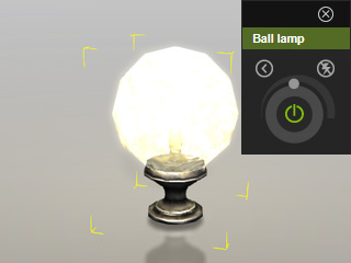

  1. Apply one of the props from the Light Tool library. A control menu for the attached light will shown at the top-right corner of the preview window.
    Note:
    1. Close Panel: Click this button to close the control menu.
      To reopen the control menu, please right click on the prop and select the Script >> Control Menu command to open it.

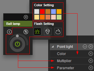

    2. Flash On/Off: Click this button to turn the light flickering behavior on or off.
      You may determine the flickering pattern within the Properties panel.
    3. Properties: Click this button to show the detailed properties such as the color of the light or the flickering pattern.

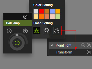

      Flash Setting
      • : The light automatically turns on and off in a constant frequency.
      • : The light randomly turns on and off like a broken one.
      • : The light randomly adjusts multiplier and intensity values to simulate a flickering fire lighting scenario.
    4. Dimmer: Drag the knob on an orbit to increase or decrease the strength of the light.
    5. On / Off: Click this knot to turn the light on or off.

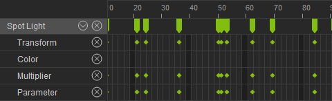

  4. The changing will be instantly recorded into the tracks of the light, including the Transform, Color, Multiplier and Parameter tracks.
    Note:
    The color settings will be recorded into the Color track, while the other adjustments will be recorded as keys into the Multiplier track.
    The transformation of the light caused by the flashing pattern will be recorded into the Transform track.
  5. Play back again to view the recorded result.
