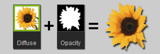

Texture
  • Diffuse - You can change the color or image for each particle.
  • Opacity - This parameter decides the shape and the transparency of your particles.
  • Please refer to Multiple Channel Texture Mapping for more details.

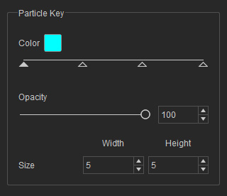

Particle Key
iClone provides each particle with four keys for the duration of its life. Every particle key stores the Color, Opacity and Size data, which will allow you to create Fade In/Fade Out effect for individual particles.
  • Click one of the four keys to change the Color, Opacity, and Size data in the key.
  • You may drag the middle two keys to re-define the timings of these two keys during the particle's life.

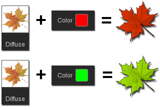

  • Color - Define a color to be blended with the image you load for the particles when they are generated/eliminated.
  • Opacity - Set the transparency for particles as they are generated/eliminated. Set 0 to make it totally transparent and 255 for opaque.
  • Opacity = 255
    Opacity = 127

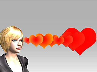

  • Size
  • The size of each particle can be modified via the settings in this group so it transforms gradually and linearly within its life span.

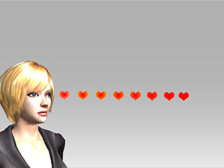

    (10x10) → (10x10) → (10x10) → (10x10)
    (10x10) → (50x50) → (20x20) → (80x80)

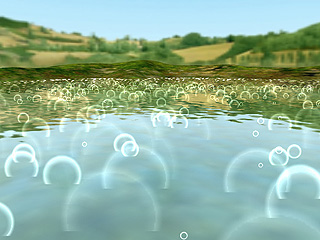

Softness Strength

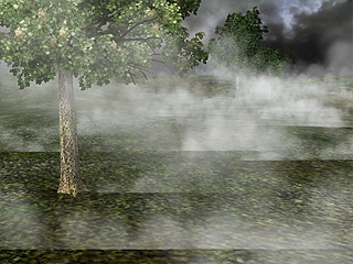

Drag the slider to decrease the seams as the particles intersect with other objects in the scene, which improves the realism of the particles.
    Softness Strength = 0
    Softness Strength = 100 (Seamless)

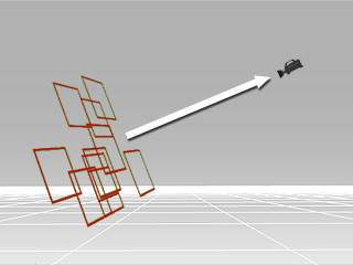

Orientation

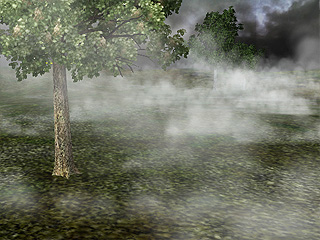

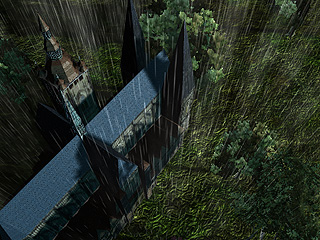

Basically, each particle is a matted billboard that will be facing the current camera all the time. However, if you want the camera to view above or beneath the particle, you will need the Orientation feature to get desired result.
  • Face Cam: This option is suitable for non-directional particles such as fire, fog or storm.
  • Vertical: This option aligns the particles to the Y axis, which is suitable for vertically directional particles such as raindrops.
  • Face Cam
    Vertical
  • Horizontal: This option aligns the particles to the floor, which is suitable for horizontally directional particles such as ripples.
  • Face Cam
    Horizontal

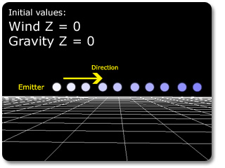

Force

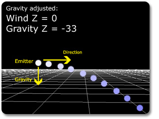

Gravity
  • It creates a force field to pull particles in a fixed direction specified by three parameters. The strength of the field increases as the values move up. The speed of the particles are accelerating per unit of time.
  • X - Particles are pulled along the X-axis. The range is from -99999 to 99999.
  • Y - Particles are pulled along the Y-axis. The range is from -99999 to 99999.
  • Z - Particles are pulled along the Z-axis. The range is from -99999 to 99999.

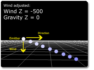

Wind
  • It simulates the effect of wind on the particles. The particles increase their velocity along the direction you set. However, the speed is constant instead of accelerating per unit of time.
  • X - Particles are blown along the X-axis. The range is from -99999 to 99999.
  • Y - Particles are blown along the Y-axis. The range is from -99999 to 99999.
  • Z - Particles are blown along the Z-axis. The range is from -99999 to 99999.
