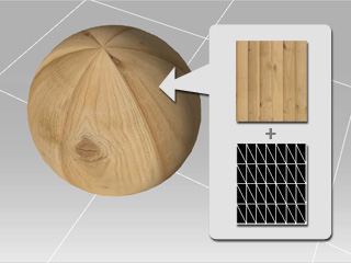

Original

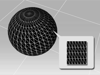

Initial UV reference of the ball
(UV reference map expanded)
Image mapping result
(Based on the UV reference map)

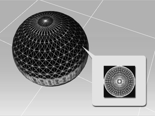

Defined by iClone
UV Type: Planar
Align: Z
(Projecting image
on the Z plan)
New polygonal UV reference map
assigned to the ball by iClone

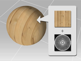

(Based on the new UV reference map)
