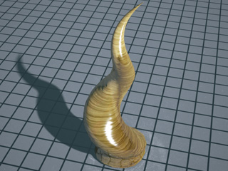

Prepare a project in iClone.
Click the Render Scene button on the
iClone Indigo Plug-in toolbar for previewing.
Check out the scene to focus on the material that you want to modify.

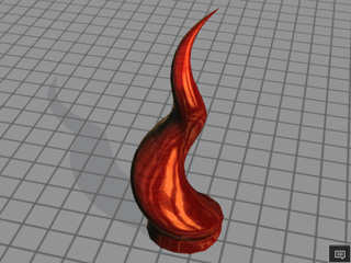

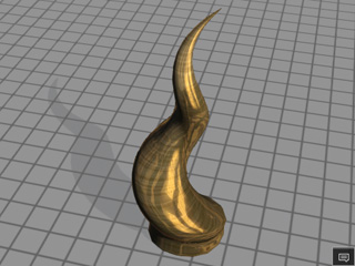

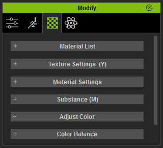

Go back to iClone and adjust the material(s) parameters
in the Modify panel. In this case, the Diffuse Color, for
example, of the sculpture is changed to red.

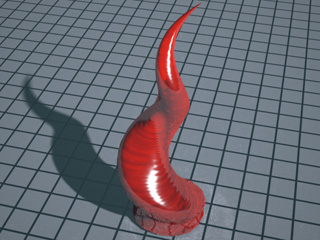

Click the Render Scene button on the toolbar again for rendering.
The materials rendered in Indigo will be kept as similar as possible to the ones you see in iClone.
