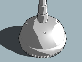

    Toon Shader = Off
    Toon Shader = On

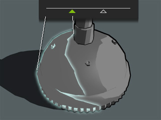

Defining the Range of Three Color Levels
The Toon Shader feature uses three color levels to present the 3-dimenstional sensations of objects. You may make the range of each level to set the objects brighter or darker. The ranges of the levels are as described as in the illustrations below:
  • You may drag the two anchors to adjust the range of each level.
  • You may also adjust the two colors by clicking the color-swatch . The gradient color of the three levels between these two colors will be automatically generated.
    Adjust the two colors. The midtone color will be auto-generated.
