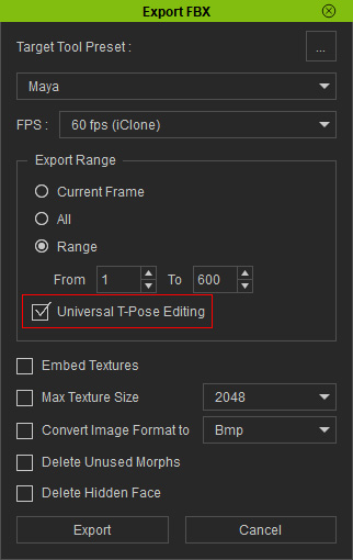

Universal T-pose Editing
If Universal T-pose Editing is activated, then you are free to create iClone compatible assets in 3rd party 3D applications.
Prepare the same project as in previous section.
Execute File >> Export >> Export FBX... command.
Activate the Universal T-pose Editing checkbox.
A T-pose will be inserted one frame ahead of the time-line motion.
