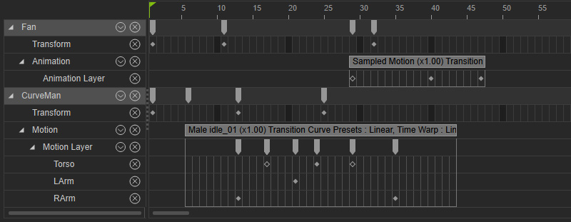

Multi-Track Data Selection
In iClone, you are allowed to select data stored in different tracks. It is convenient to edit data at one time instead of editing separately in different tracks.

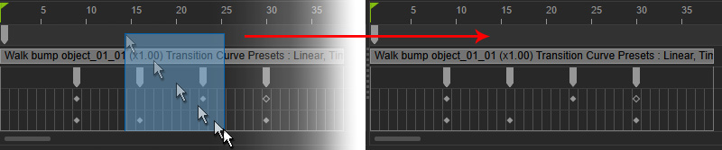

In iClone 6, you can even use Box Selection:
Use Ctrl + drag a rectangle across different tracks to select multiple keys / clips that belong to different objects.
- Use Ctrl + LBM to select multiple keys / clips in different tracks.
- Use Ctrl + double-click on a sub track name to select all the data in different tracks.
Drag the cursor to include a range in the Dope Sheet track of an object to select multiple keys / clips from the sub tracks.

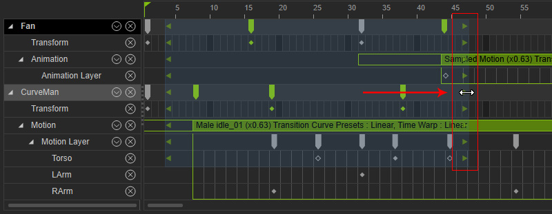

Multiple Keys, Clips Selection and Scaling:
This feature is applied to span tracks and objects.
- Prepare multiple objects with clips and keys, then open their tracks in the Timeline.
- Hold the Ctrl key and drag out the selection box to include the clips and keys you wish to select.
- Drag the arrows at either end to scale up or down the distances between keys.
The distances may be auto-adjusted because they snap to align with the closest frame.
Note:Note that the size of the cell frames in a clip will be adjusted accordingly when scaling up and down.
- Move your cursor into the blue selection range, and it will
change to a hand icon.
Drag to move the clips and keys within this range as a single block.
