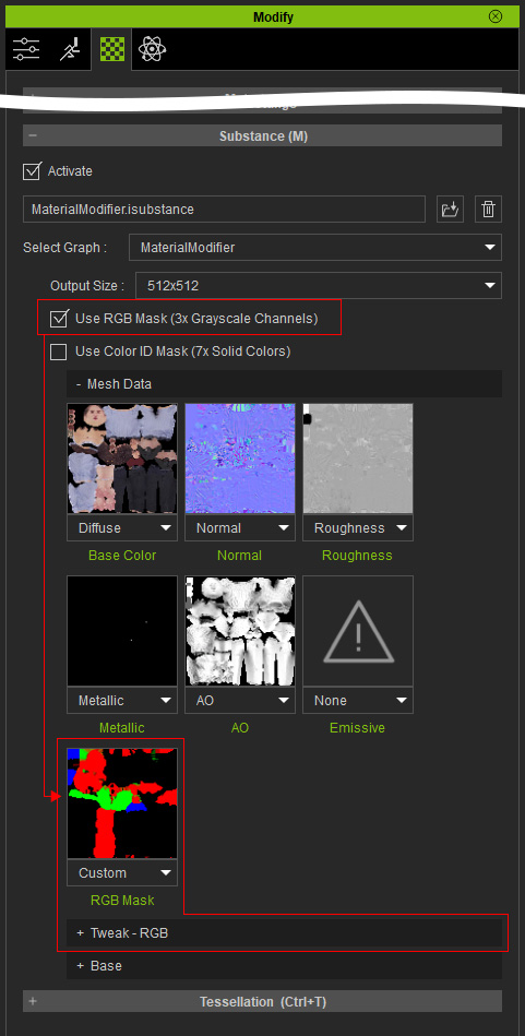

The RGB Mask Layer is the top layer in the Material Modifier mechanism.
And this layer is composed of three different sub-layers, Red, Green and Blue.
The RGB Mask is an image which integrates grayscale regions data in Red, Green and Blue channels which divides the character's material into specific parts.
With the data, you can separately adjust partial material through the Tweak - RGB Sub-section, unlike the Base subsection that is mostly used to adjust the entire character's material.
- The RGB Mask in this channel is auto-loaded from the RGB Mask channel in the Resource Map section.

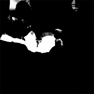

- The RGB Mask texture is composed of R, G, B channels with individual grayscale data.
RGB Mask Texture
Grayscale Data in Red Channel
Grayscale Data in Green Channel
Grayscale Data in Blue Channel
- The RGB Mask texture accepts grayscale data, which can be used to create blurry edges by the gradients, especially the seam between the hair and material underneath it.
RGB Mask Settings
In the Tweak - RGB subsection, there are subsections for adjusting the colors in the R, G, B regions.
You can activate the Check RGB Mask checkbox to view the RGB regions distributed on the character.

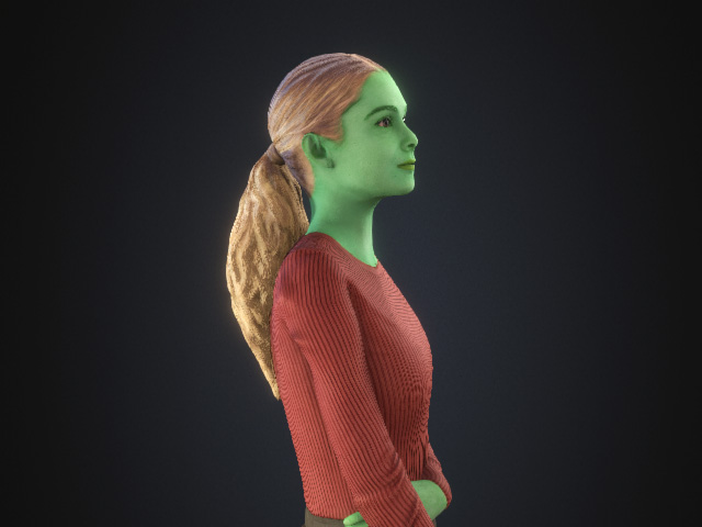

Settings in Red (Skin), Green (Hair) and Blue (Oral Cavity) Subsections
There are identical settings in the three sub-sections to adjust the specified regions, Skin, Hair and Oral / Cavity.
This value is used to individually adjust the intensity of the regions for the 3 sub-layers. The lower the value is, the more the Base layer effect shows, and vice versa.

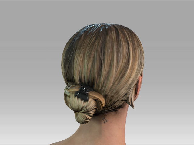

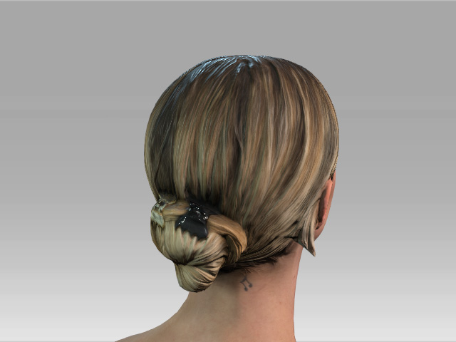

This setting is mostly used to smooth out the sharpness edges of the regions (defined by the image channel data), such as the seam of the hair and forehead.
Green (Hair) > Blur = 0.00 (Default) |
Green (Hair) > Blur = 5.00 |

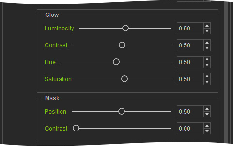

- The Position values dynamically expand or contract the masks edges defined in the Red, Green and Blue channels.
Green (Hair) > Position = 0.50 (Default)
Green (Hair) > Position = 0.90
- The Contrast can be used to distinguish or weaken the edges of the masks.
Green (Hair) > Contrast = 1.00
Green (Hair) > Contrast = 0.00
