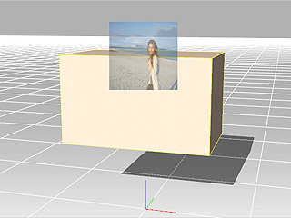

Drag and Drop With Ctrl Pressed
If you drag and drop an image or video while holding the
Ctrl key, a simple board that is mapped with the image or video will be generated.
And it works great with popVideo as well.
If you drag and drop a PNG image that contains alpha channel data, iClone will automatically take care of the masking for you.
You can modify the transformation data of the board to increase its size, width, depth, etc.
The board will snap to the grid differently depending on your viewing angle to the world axis.

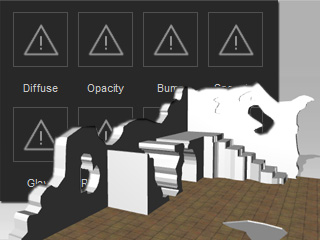

Material

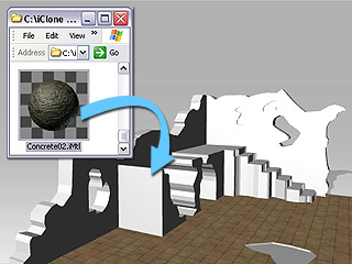

Drag and drop a material file (.iMtl) to any dragable object (with mesh, trees excluded) and the images in the seven channels will be replaced with the ones saved in the material file.
Before Drag and Drop .iMtl file onto the prop |
Drag and Drop .iMtl file to the target face |
