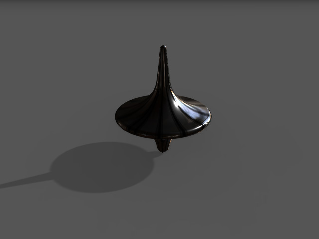

In the 3D world, each object can rotate by three axes, a.k.a. Gimbal and is based on a certain gimbal axes order to rotate. Different rotational orders generate different rotational results.

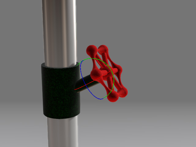

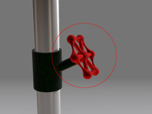

  1. Create a new project in which the rotating object tilts a little.
  2. Select the object and switch to the Local Rotate tool (Shortcut: E) to view the local rotational axes.
    In this case, the Blue gimbal is the ideal axis for rotating the object.

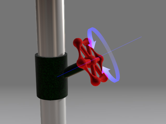

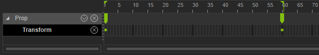

  3. Set two rotation keys (by Blue gimbal axis).

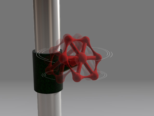

  4. By default, the Rotation Order is XYZ, and the rotation will become erratic.

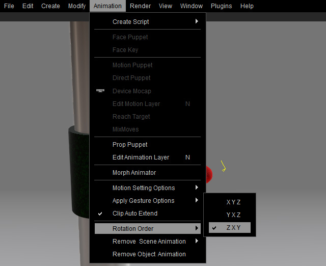

  6. Activate the Animation menu >> Rotation Order >> ZXY.
    Because the Blue gimbal is the ideal one for rotation in this example, the Z axis should be taken as the first priority.
  7. Playback to view the result.

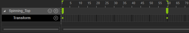

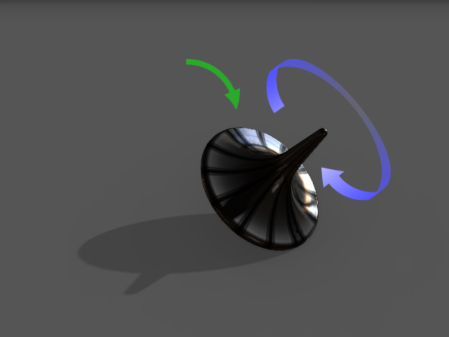

    For the second key, the object spins by the blue gimbal and tilts by the green gimbal to stop.
