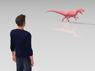

Apply a character and a target object (such as a prop).
- Move to another time frame where you wish the character to point at the target object.
Pick the character,
click the Reach Target
button under the Animation tab of the Modify panel to access the
Reach Target panel.
Select the right hand effector point from the left dummy pane.
Click the Pick Target
button, and
then pick any object on the 3D preview window to specify the target. The right hand
effector point will turn
from
to
; which indicates that
the corresponding body part is pointing at an object.
The character reaches out the right hand and points at the prop.
