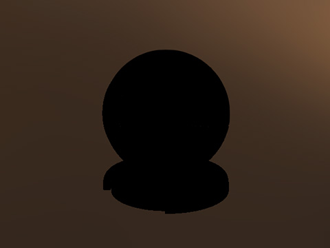

The illustration below is a scene in which all the lights are out.
- Click the Launch button to invoke the external image editor.
Modify the image. If you are a beginner, it is recommended to set the image black
first.
Save the image and switch back to iClone.
Repeat steps 2 and 3 until you are satisfied with the result.

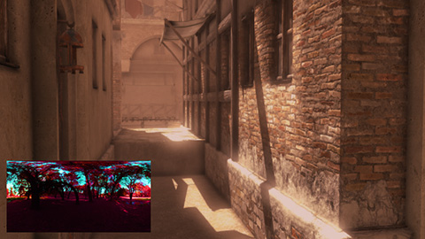

Editing with Color Adjustment Panel
By modifying the color settings of the IBL image with the Color Adjustment panel, you may quickly change the tone of the scene.
Apply an IBL image. (you may use custom image or apply from the template library)
Click the Adjust Color button under the IBL image to open the Color Adjustment panel.
Drag the sliders in the panel to change the entire tone of the image.Note:
Please note that if the IBL image is in HDR or EXR formats, then the adjustable sliders will be limited as shown in the illustration above.
Adjust the parameters in the Color Level and Color Balance sections.
