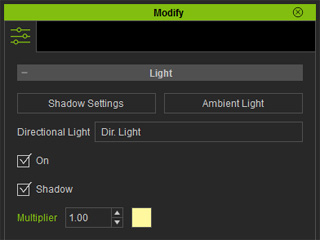

Prepare a project with a default light.
- Select the light in the Scene Manager and go to the light modify panel.
Change the light color to light yellow.
Increase the light strength by adding values to the Multiplier.
Multiplier = 2.5
The light is brightened while the color of the light remains the same.

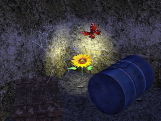

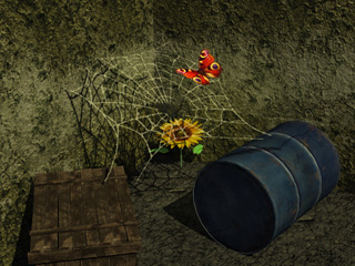

Multiplier, Spotlight and Point Light
With the same concept, you may use the Multiplier to highlight the light center cast by the spotlight or point light.
- Spotlight
The spotlight effect is dramatized after the Multiplier is increased to 3.
- Point Light
The point light effect is dramatized after the Multiplier is increased to 3.
