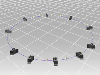

Dummy to Path
  1. Create a path for the camera to move on.
  2. Select the dummy and Pick Path to the path.
  3. Since we have set the dummy as the parent of the camera, the dummy will move along the path with the camera.
  4. You can now set the position keys for the Dummy on the path while also adjusting the Camera's rotation and position.
