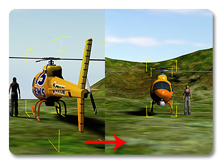

Quick Camera Positioning
A - Left
S - Right
D - Back
F - Front
G - Top
J - Face
K - All

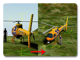

Home - 45 Degrees
Press F to view the selected
object (character,
accessory, prop) face front.
Press Home to snap the camera
to a 45 degree perspective of the selected object (character,
accessory, prop).
