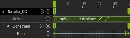

    Two types of data in the Timeline
    (motion clips and transform keys).

    The two types of data in theTimeline
    (motion clip and path keys).
