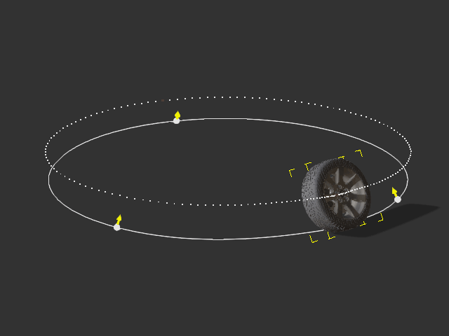

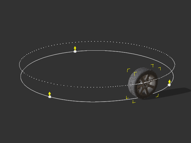

Given a tire that has movement along the real route as an example.

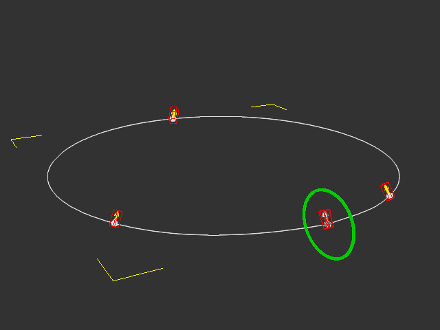

- Adjust the direction of the control points (the tire is hidden for better observation).
- Have the tire follow the orientations of the control points.

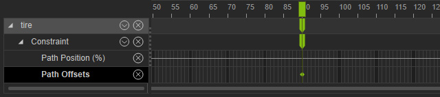

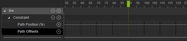

- Go to the middle time frame of the entire animation.

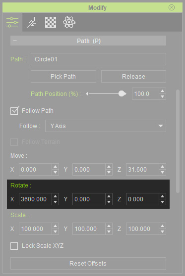

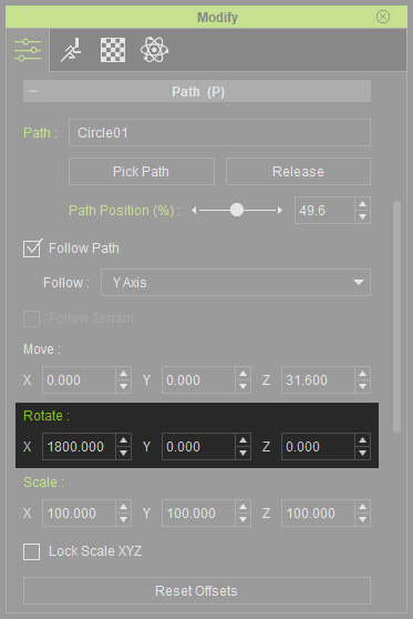

- Adjust the Rotate values in the Path section of the Modify panel.
You will see a new offset key is added into the Path Offsets sub-track.
- Playback to view the result.
- Go to the last frame, adjust the Rotate fields mentioned above to keep the tire rolling.

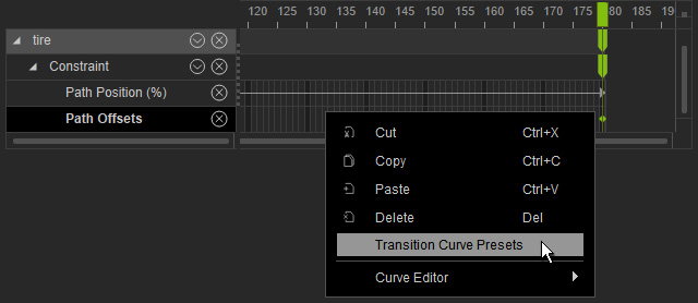

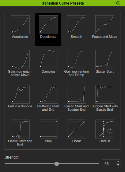

- Right click on the path offset key and choose the Transition Curve Presets from the right-click menu.
- Pick the Decelerate template to have the tire to gradually stop and slide back to the original position.
