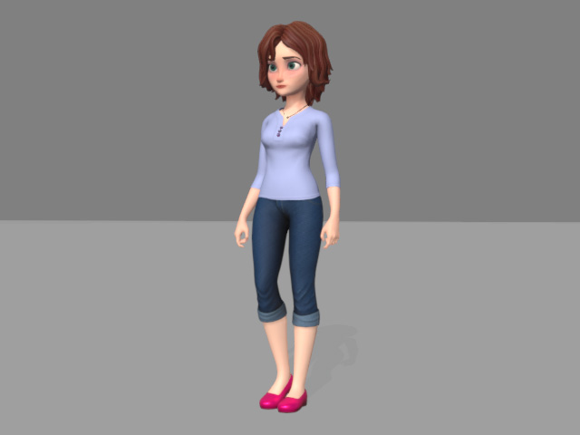

Apply a character. Initially, it is still with only an idle pose.

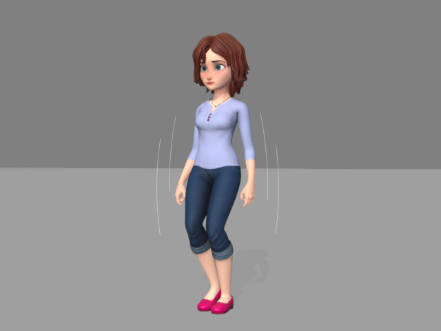

Toggle the Screen-based Movement mode and record the hip movements.

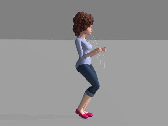

Toggle the Screen-based Movement mode and record the hands movements.

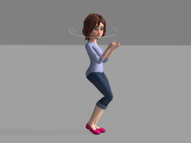

Toggle the Primary-Rotation mode and record the head movements.
