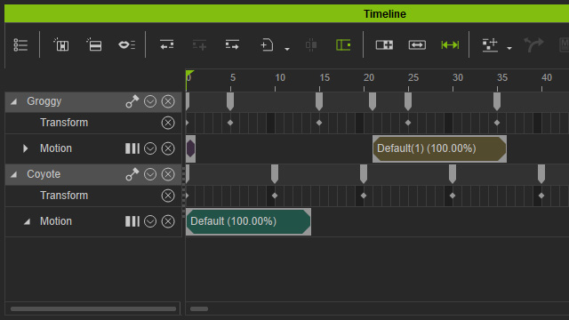

Here's a project in which objects are all animated by clips and keys.
- Press F3 to open the timeline. Click the Track List button and select Project from the menu.

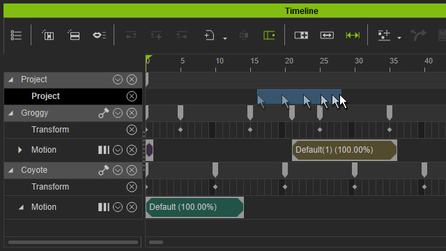

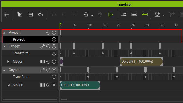

Focus on the Project sub track.
Drag in the track to make a range for deletion.
You can drag each side of the range to modify the length for deleting. -

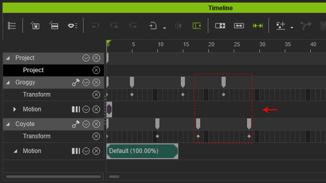

You will then be prompted to choose the deletion method.- Delete Data: Deletes only the clips and keys within this range.

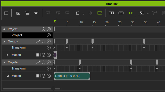

- Delete Frame: Deletes keys as well as the frames within the range to shorten the length of the project.
If you Delete Data, the data within the range will be removed. The data after the range
will stay where it is.
If you Delete a Frame, the data and frames within the range will be removed and the data after the range will be advanced.
