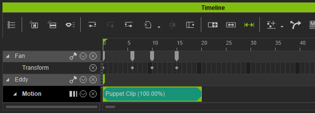

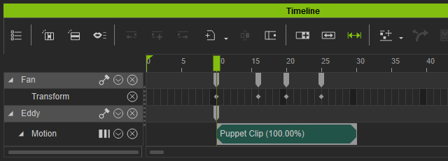

Open a project with animations on different objects. Start from the
first frame.
- Open the Timeline (F3).
Click the
Insert Frames button on the toolbar. Enter a frame number before the start frame.
Click the OK button and the specified number of frames will be added before the start frame.
The initial animations will then be postponed and the total duration of the project will be increased.

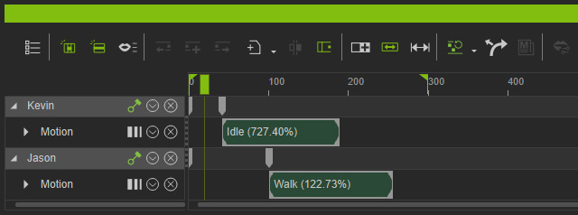

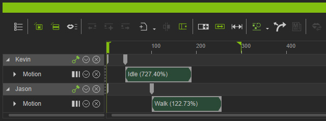

Given a project as the following illustration:
- The play head sits before the start frames of both clips:
The play head sits before the start frames of the clips.

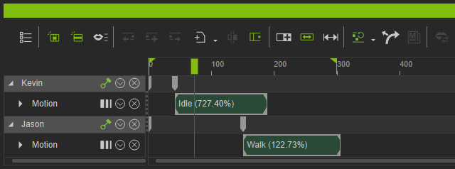

The specific frames (50, in this case) are inserted before both clips.

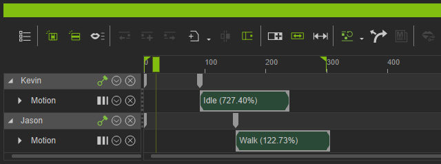

- Play head sits between the start frames of both clips.
The play head sits between the start frames of the clips.
The specific frames (50, in this case) are inserted before the starting frames after the play head.
