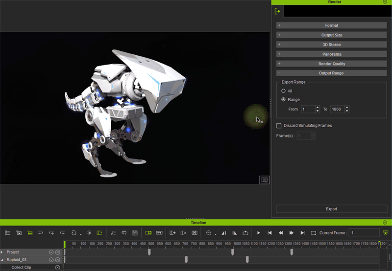

Setting Project Start/End Frame Markers
There are two methods for marking the start and end frames for playback and export. The first involves dragging the markers directly on the timeline, while the second utilizes the toolbar buttons and corresponding hotkeys.
You can set the total project length in the Project Settings panel.

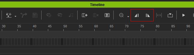

- The Hotkeys: Mark in ( Ctrl+[ ) / Mark Out ( Ctrl+] ).
The buttons on the Timeline Toolbar.
You can drag the play head to the desired time frame and set the markers.
