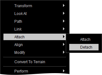

- Go to the Attribute tab of the Modify panel and scroll to the Attach section, click the Pick Parent button. Alternatively, you may right-click on it and select Attach in the Right-click Menu.
