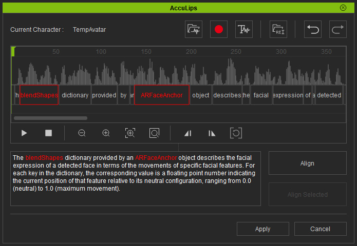

Adding Unknown Words to Dictionary

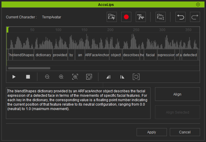

- Launch AccuLips, load a voice and create text.

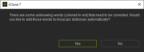

- When the text is produced, you will be instantly asked to add unknown words into the dictionary.
- If you click the No button, then the unknown words will not be added into the dictionary and they will appear in read.
- If you click the Yes button then the unknown words will be added into the dictionary and they will appear in white.

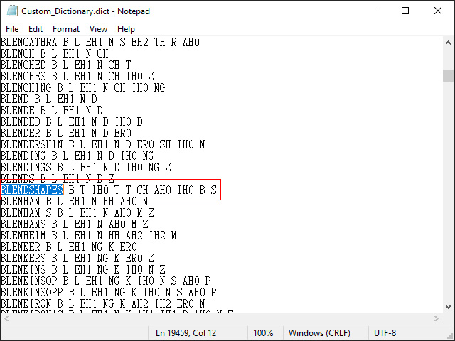

- The added word will be paired with best-guessed visemes that are automatically produced by the AI.

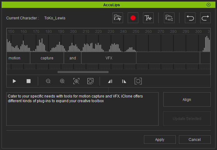

- Launch the AccuLips feature to create text from and align words to a voice.

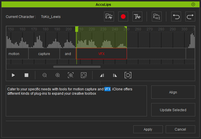

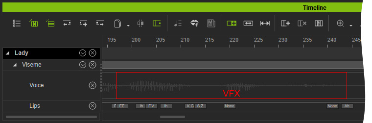

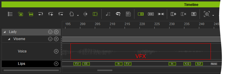

In this case, the VFX is an abbreviation and had not been included in the AccuLips dictionary. - Click the Apply button to create visemes for this voice. Open the Timeline and display the Viseme, Voice and Lips tracks.
- Manually editing (setting strength, dragging, adding, deleting, and re-position) the auto-generated visemes to the proper timeframes.

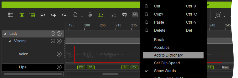

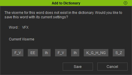

- Right-click on the word block and choose the Add to Dictionary from the pop-up menu.
- The Add to Dictionary panel shows for you to confirm the word and the visemes. Click the Save button if the result is satisfying.
- The word block becomes green, which indicates that the word has been added into the dictionary.
- When AccuLips encounters the word again, it will be able to recognize it and mark it in white.
