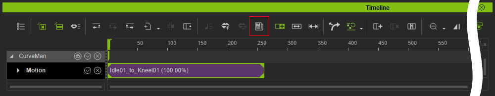

- Launch the Timeline (Keyboard Shortcut:F3), open the Motion track of the actor.
- In the Motion track, you can see the motion clip added in step 1.
Click the Motion Modifier button on the Timeline.

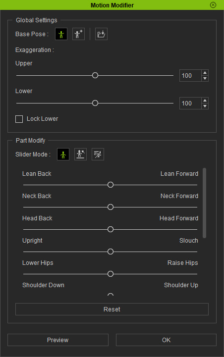

Adjust the motion clip with the Motion Modifier panel.

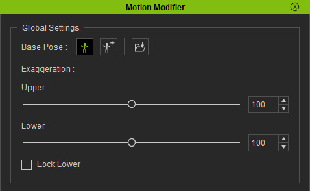

Base Pose and Exaggerations
The Base Pose is used as reference when you want to alter the entire strength of the
motion. After the base pose is determined, you are able to increase or decrease the exaggerations
of the motion clip for the upper and lower body.
- Default Pose
: For most of the motion clips, especially motions that do not change much throughout the entire clip, click this button to use the default pose as the base reference for modification.
- Auto Generate
: For the motions that change a lot from time to time in clips, click this button for auto-calculating the average pose of the clip as a base reference.
- Load
: You are allowed to load an iMotion to use the first pose of it as a base reference.

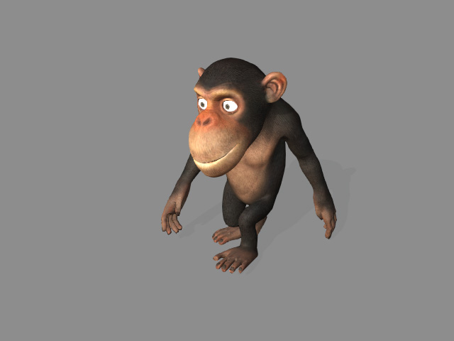

Load an actor. Apply a motion to the actor.
Playback to view the result. - In order to create a cohesive motion suitable to the character's personality, open the Motion Modifier as described above.

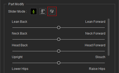

Click the Stand Mode or Move Mode buttons in the Part Modify section
(in this case, the Move Mode is pressed).
- Click the Preview button and press the Space bar to start previewing (Shortcut: Spacebar).
- Drag the sliders in the Part Modify section.

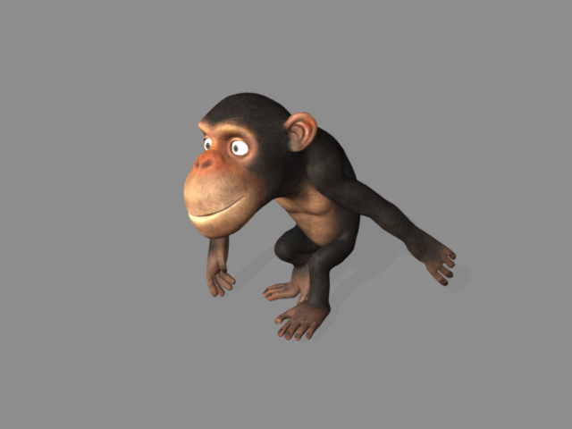

Click the OK button and the entire clip will be converted into an altered one.
