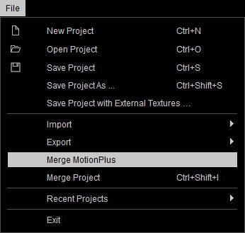

Click the File >> Merge MotionPlus command from the main menu bar.
Select the MotionPlus file exported in the previous step.

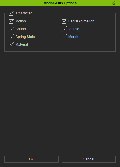

You will be prompted with the filter dialogue box below. Activate the Facial
Animation box to ensure that only the voice, lip-synching keys and the
facial expressions in the MotionPlus are extracted and applied to
the actor.
