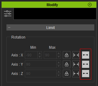

- In the Limit section, you are able to define the
rotating limits for the three axes (in this case, three axes are set
Free).
Please refer to the Setting Constraint Limits section for more information. - Set transform keys or puppet kinematic objects to hit the dynamic
