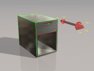

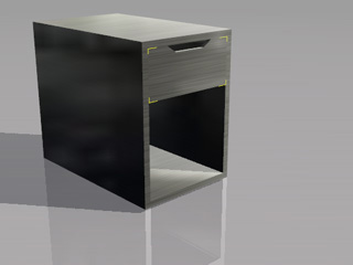

Apply a prop (in this case, a drawer). Transform it to a desired position, size and angle.
- Set the prop as Dynamic.
Because the Dynamic rigid body will fall by default, you need to constraint it to
its current location.
In the Modify panel >> Physics tab >> Constraint section, click the Add Constraint button.
The Add Constraint panel displays. -

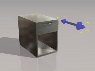

Drag and drop the Slider template onto the dynamic rigid body.
Make sure the constraint is selected.
Optionally transform the constraint to desired position, angle or size so that you may easily observe the constraint.

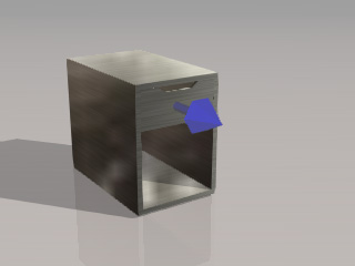

In the Modify >> Constraint section, you can connect the constraint to the
cabinet by clicking the Pick Target or World buttons.
Please refer to the Setting Connection Relationship
section for more information.

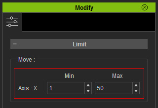

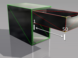

In the Limit section, you are able to define the
distance limits for the X axis. Please refer to the
Setting Constraint Limits

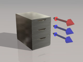

Duplicate the drawer. The constraints and the targets are also duplicated.

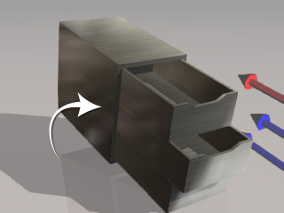

Tilt the cabinet and the drawers will open automatically. But they stop
at the specified distance instead of dropping on the floor.
