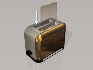

Apply a prop (in this case, a piece of toast). Transform it to a desired position, size and angle.
- Set the prop as Dynamic.
Because the Dynamic rigid body will fall by default, you need to constraint it to
its current location.
In the Modify panel >> Physics tab >> Constraint section, click the Add Constraint button.
The Add Constraint panel displays. -

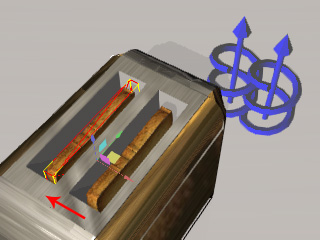

Drag and drop the Spring constraint template onto the dynamic rigid body.

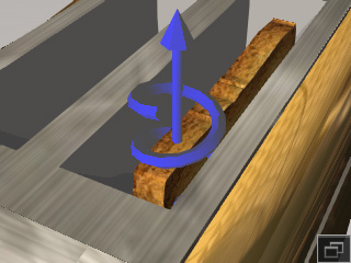

Transform the constraint for better observation, and for the arrow to point to
the direction so that the rigid body is able to perform the spring-moving animation.

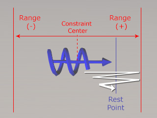

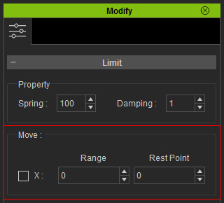

In the Limit section, check the
box in the Move section and define the bouncing
Range and Rest Point for the spring effect.
- Range (+), (-): The relative distance from the current pivot position.
- Rest Point: The relative position of the rigid body when the spring effect stops. It is highly recommended that you use a value between the Range (+) and Range (-), otherwise the spring effect will become unexpected when you begin the simulation.

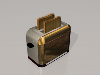

Duplicate the toast (Shortcut: Ctrl + drag with Left Mouse Button). The physics settings are also duplicated, including the constraint
settings.
Play to simulate the spring effect. You will see the toasts are bouncing
up and down.

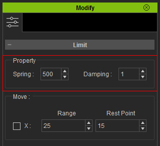

In the above example, you may find that the spring effect keeps going, which seems to never decrease and never stop. In the
Property section of the same panel,
you are able to set the Spring and Damping values to define the
strength of the spring effect and
how hard the resistance will be to slow down the spring effect.
In the last example, the Spring is set to 500, which causes the strong bouncing behavior. If you decrease the value to 50, then the spring strength is also weaken and more gentle.

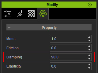

If sometimes the spring effect does not seem to stop, it is because the Spring value is too high, and the Damping value is not enough to ease the bouncing in a short time. In this case, you can select the rigid body and go to the Modify >> Physics tab, increase the Damping value for the rigid body. With these two damping values set higher (one for the constraint and the other for the rigid body), the spring effect will stop sooner.
Spring: 500, Constraint Damping: 95, Physics Damping: 90 |

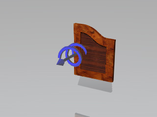

hinge part of the dynamic rigid body.
Transform the constraint to the hinge of the dynamic rigid body, and
make sure the swirl part of the constraint is parallel to the hinge.

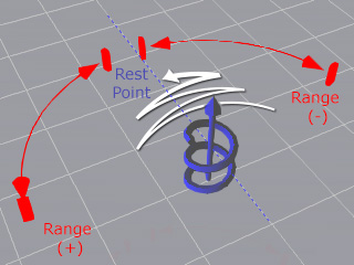

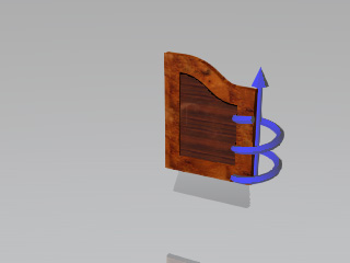

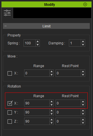

In the Rotation section of the Limit
section, activate the axis the constraint is about to rotate (in this
case, X) and set the Range and Rest Point values
to define the bouncing range.
- Set the Spring, Constraint Damping and Rigid Body Damping as described above.

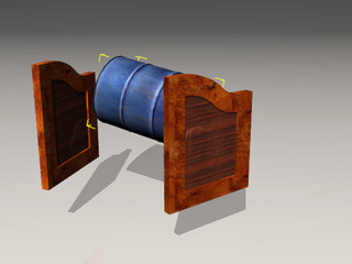

Duplicate the board (Shortcut: Ctrl + drag with Right Mouse Button). The physics settings are also duplicated, including the constraint
settings.
Prepare a kinematic object to pass through it. Simulate the result.
