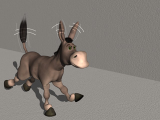

  1. Load a character or a prop with spring effects on specific bones (in this case, the character has been given spring effects on the ears and the tail bones).
  2. Apply motions to the character, you can see the spring effect triggers the bones to auto-bounce.
    Bones with Auto Spring Effects: The ears and the tail.

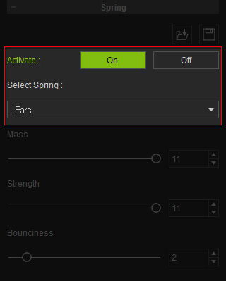

  3. Make sure the character is selected and go to a specific time frame when you want to turn off the spring effect.
  4. In the Spring section of the Modify panel, select the bones for which you want to turn the spring effects off via the Select Spring drop-down list.
  5. Press down the Off button.
  6. Go to another time frame, click the On button to turn the spring effect on again.
  7. Play back to view the result of the different spring effect settings.

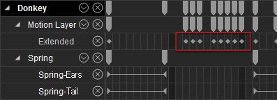

    • The Spring keys can be found in the character or prop's Spring track in the Timeline.
    • Please refer to the Spring Track section for more information.

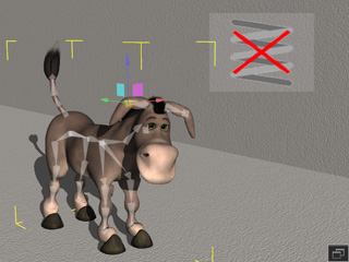

Manually Animating Bones with Spring Effects Off
When the spring effect of a bone string is turned off, you are able to manually adjust the bone via IK or FK methods to create key-frame animation for it.

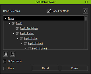

  1. Select the character or the prop (with spring effects) and go to the time frame when the spring effect is off.

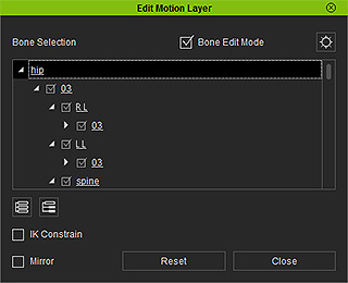

  2. Launch the Edit Motion Layer (for Actors) or the Edit Animation Layer (for Props) panels.
  3. Manually modify the bones via the IK or FK methods within the time during which the spring effects are off.
    IK method.
    FK method.
    The modification results will be kept in layering keys on the Motion Layer (for Actors) or Animation Layer (for Props) track.
  4. Play back to view the result.
