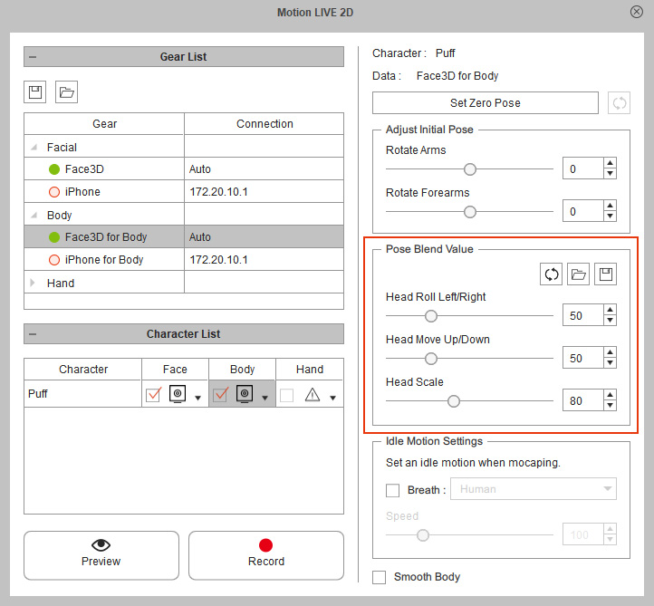

In order to maintain a natural connection with the head and upper body during the mocap process, the Motion LIVE 2D plugin provides the Pose Blend Value sliders, which can also be used to make the animation more vivid and lively. You can accentuate or diminish the values to match the personality of the character you are using. The benefits are:
- Control the signal input strength from head movements to trigger the motion patterns for the upper body.
- Enhance the facial expressions with proper Pose Blend Value settings.
- Save the settings for the characters.

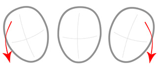

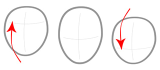

Adjust the Head Roll Left / Right slider to determine the facial body motion strength for tilting the upper body left and right.

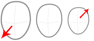

Adjust the Head Turn Up / Down slider to determine the facial body motion strength for stretching and squashing the upper body.
- If you are using facial mocap for head nodding, you may need to lower the value of this slider to correct the head movements for the current version.
- In the current version, if you are using the facial mocap for a character with a side face pose near 270 degrees and capturing the head nodding motions, please use the Head Roll Left / Right slider to correct the head movements.
Adjust the Head Scale slider to determine the facial body motion strength for enlarging or reducing the size of the head.
- By double-clicking on the name of the sliders, you can reset the values back their default values.
