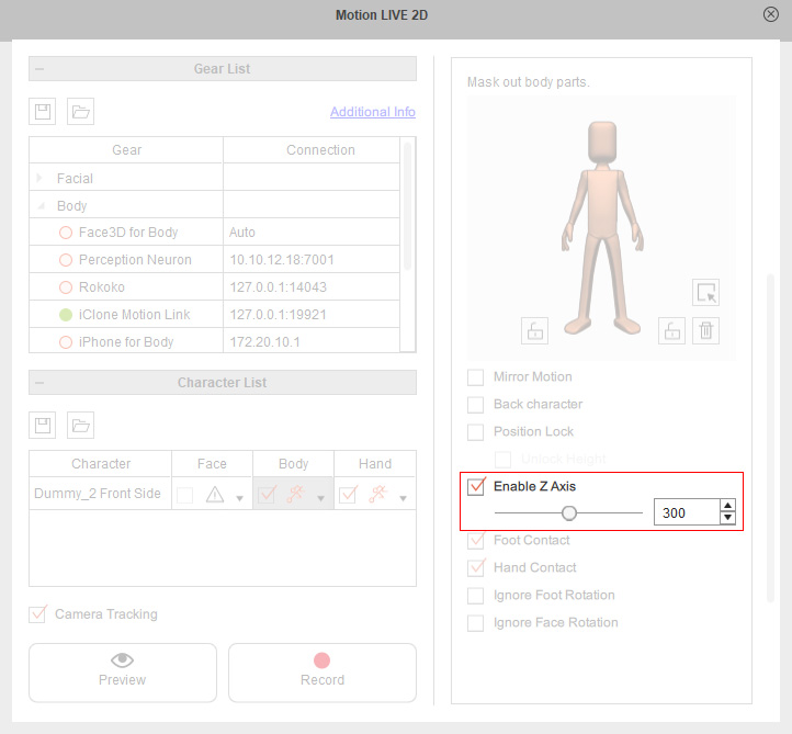

Z Axis strength = 300 (default).
| Z Axis strength = 150.

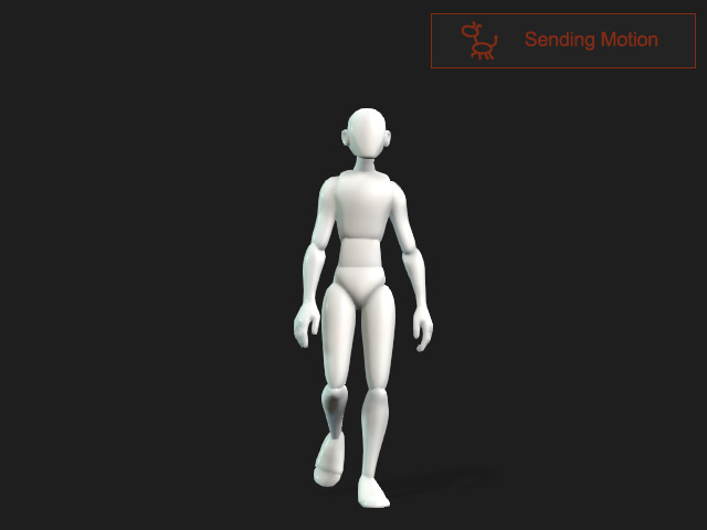

- In iClone, drag a walking motion to the dummy character for Motion Link.

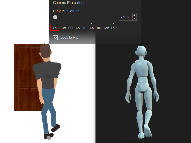

- Set the Projection Angle by clicking the -180 or 180 angle preset for the back character in this case.
The dummy character and the CTA character (limb bones) will turn to the rear view.

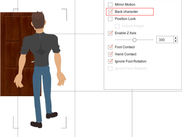

- Go to Motion LIVE 2D.
Enable the Back Character checkbox to the swap the CTA character's body parts.
Enable the Ignore Foot Rotation checkbox to ignore the foot rotation in this case.

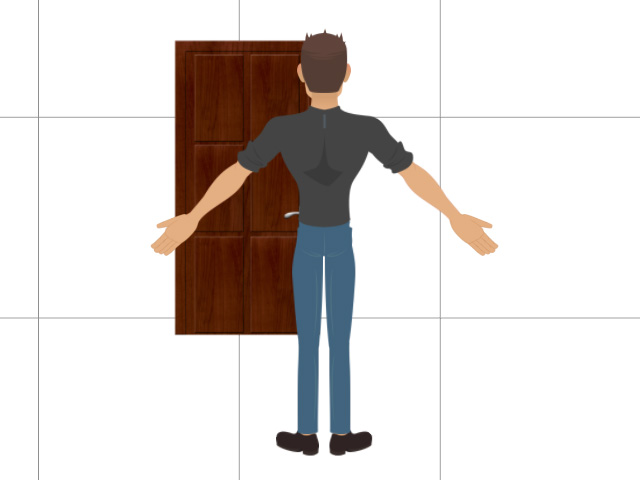

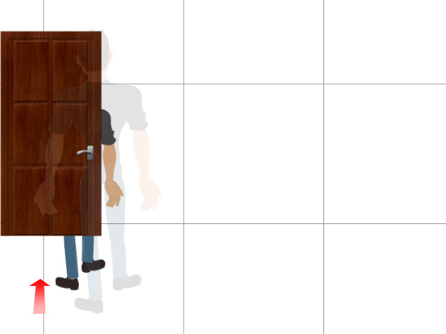

- Back to Motion Link, click the Preview in CTA button.
The CTA character will walk forward and be blocked off by the door in this case.

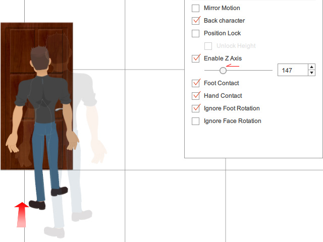

Drag the Enable Z Axis slider to the left to decrease the Z axis strength.
Now the character won't be influenced by the prop.

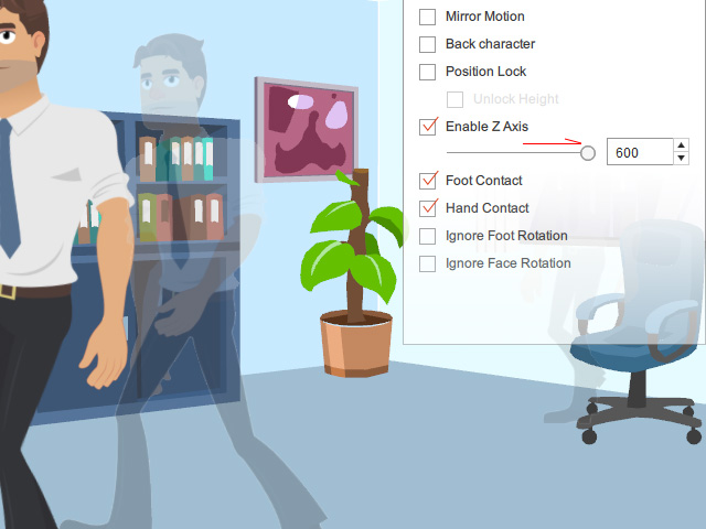

You can increase the Z Axis strength to enhance the visual impact of the 2D animation.
| Z Axis strength = 600.

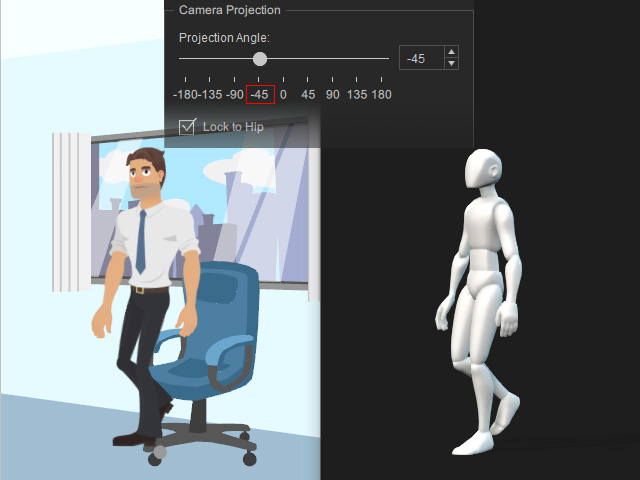

- Set the Projection Angle by clicking the -45 angle preset for the side character in this case.
- Click the Preview in CTA button.
The CTA character will walk forward.

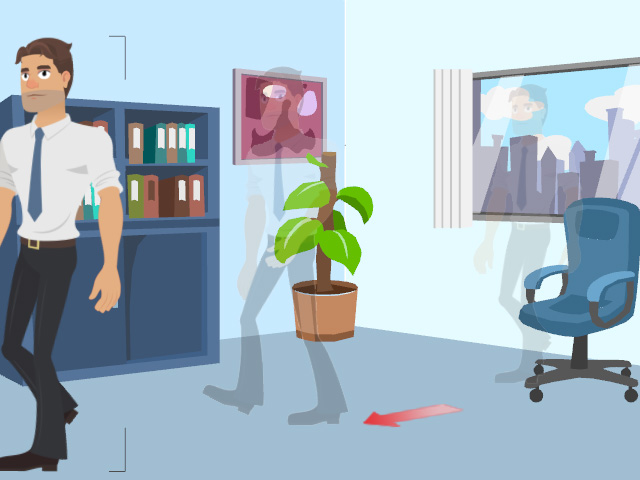

Drag the Enable Z Axis slider to the right to increase the Z axis strength.
Now the character will walk closer to the camera and off-screen.

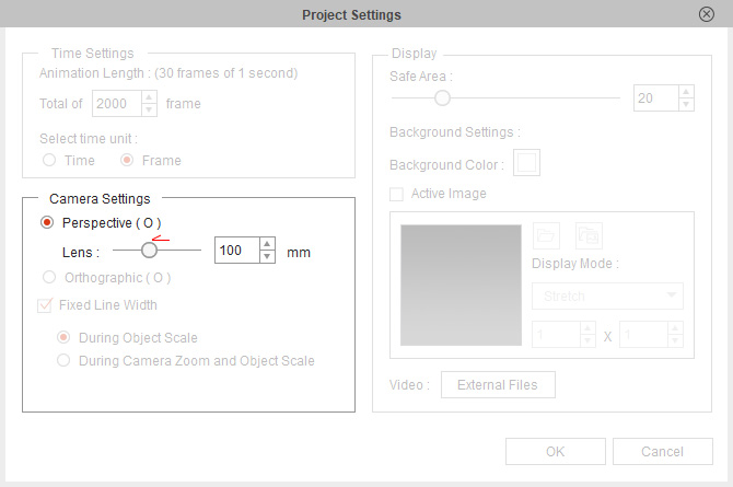

You can also decrease the Lens value in the Project Settings for an even greater effect.
