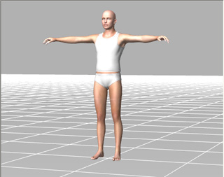

Before starting this pipeline, you need to prepare a Genesis character in FBX format from DAZ 4.

  1. Load the prepared DAZ character (in FBX format) into 3DXChange.
  2. Characterize the character into an iClone non-standard character.

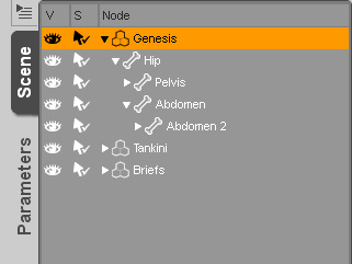

  1. Go back to DAZ, click the Scene tab and select the Genesis node.

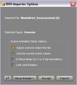

  2. Execute the File >> Import command and select one desired motion file from the exported BVH motion files.
  3. When the BVH Importer Options panel shows, choose the Adjust scene to match the file radio button.
  4. Click the Accept button to apply the selected motion.
  5. Click the play button to view the motion result in DAZ.

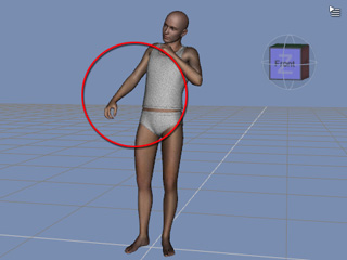

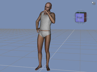

Because in DAZ, each joint of a character is constrained to a limited rotation angle, when the rotation of one or more joints are too extreme, DAZ locks up the joints to force what it calculates to be the most reasonable character pose.

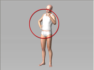

The motion in 3DXchange.

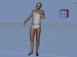

The motion result in DAZ.

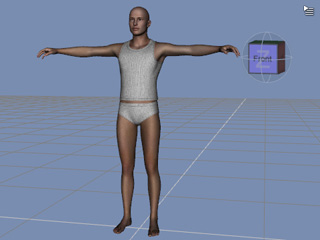

If you want the motion to be completely identical to what you have in 3DXchange, then please follow the steps below:

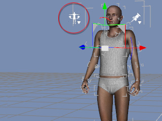

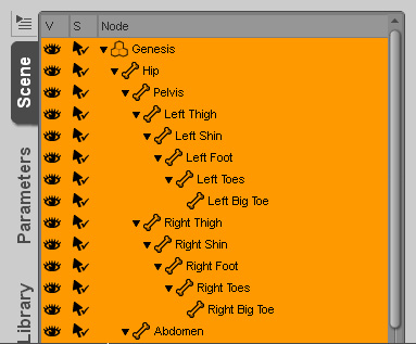

  1. Select all bones of the character in the Scene tab.
  2. You will see an icon of a small man show up.
  3. Click on the icon and then select the Limits Off (Rotation) command from the pop-up menu.
  4. Re-import the motion again.
  5. Play back and the motion will be totally the same as the one you see in 3DXChange.
