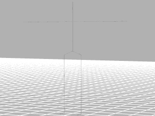

  1. Load the prepared Shade bone structure (in FBX format) into 3DXChange.
  2. Characterize the character into an iClone non-standard character.

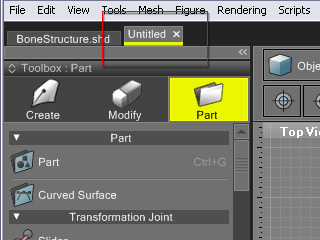

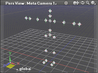

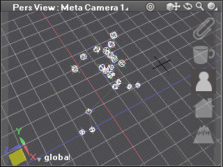

  1. Go back to Shade, execute File >> New to new an empty scene.
  2. Execute the File >> Import >> BVH command to import the exported FBX motion file to the new scene.

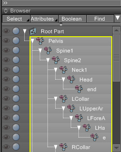

  3. Select the motion root node (in this case, the Pelvis) of the structure from the Browser panel.

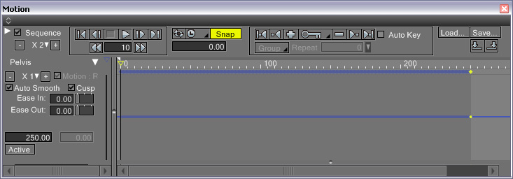

  4. Open the Motion panel.

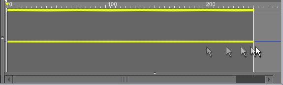

  5. Drag to select all keys on the timeline.
  6. Click the Save button at the right-top of the panel to save the animations of each bone into a Shade motion file (*.shdmtn, *.mtn).
  7. Switch back to the scene with the original bone structure.
  8. Select the motion root node (in this case, the Pelvis) of the structure from the Browser panel.

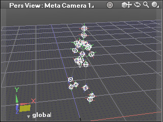

  9. Click the Load button in the Motion panel and load the saved motion file in the previous step. Only the first pose is loaded to the bone.
  10. Click the Load button to load the file again. The motion is then applied to the bone.
