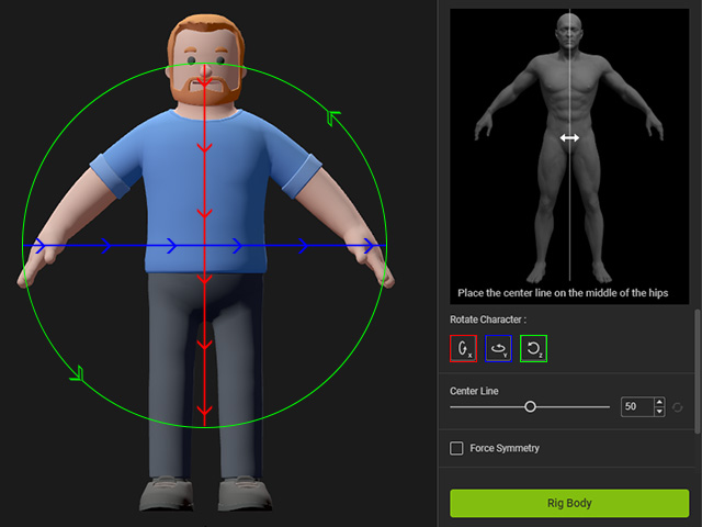

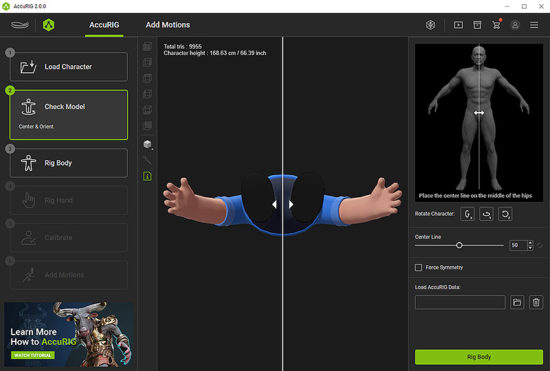

In the Check Mode step, you can rectify the model's orientation, as other 3D tools can have different coordinate systems from AccuRIG. In addition, you can reposition auto-rigging's center line according to the current model.
Rectifying Model Orientation
The model may be facing another direction when loaded due to the differences in the source application's coordinate system.
You can use the three rotate buttons to rectify the model's orientation.

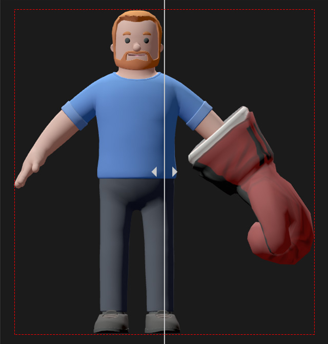

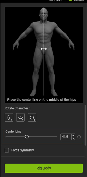

The center line defines the center of the hip.
It is, by default, set to the center of the model's bounding box, however, when the model's pose is not symmetrical, the center line will shift to the side.

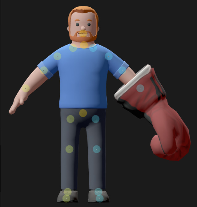

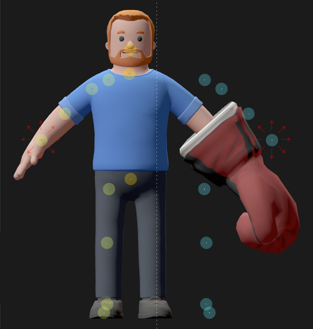

Incorrectly positioned center line can lead to two issues:
- Issue one: The automatic distribution for the joints in the next step will be crooked.
- Issue two: The symmetrically re-positioned joints in the next step will be displaced.
You can manually drag the center line to re-position it properly.
You can also use the slider or adjust the number field to set the position of the center line.
The system will distribute the joints as correctly as possible, and afterwards, you will only need to make some slight adjustments.
