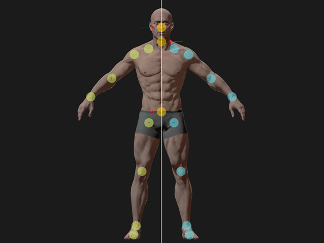

The Snap to Center Plane feature is a tool for quickly re-centering the head, neck and pelvis joints of your model.
The head, neck and pelvis joints are off-centered.
The head, neck and pelvis joints snapped to center.

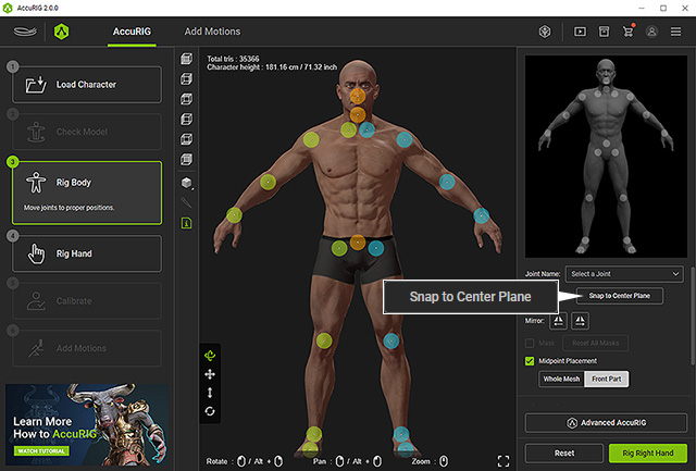

  1. Load a character in the Load Character step.
  2. In the Check Model step, set the center plane by repositioning the center line.
  3. Go to the Rig Body step, randomly move the head, neck and pelvis joints.
  4. Click the Snap to Center Plane button to snap these three joints simultaneously to the center plane
    This step ensures that they are properly aligned and positioned for rigging.
