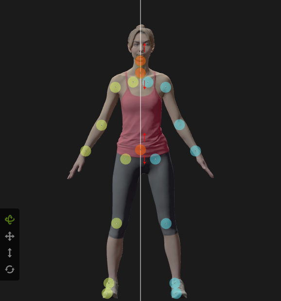

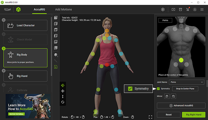

In the Rig Body step, you can activate the Symmetry checkbox for two purposes:
  • Snapping the head, neck and pelvis joints to the center plane while are you moving them.
  • Simultaneously repositioning bi-lateral joints.

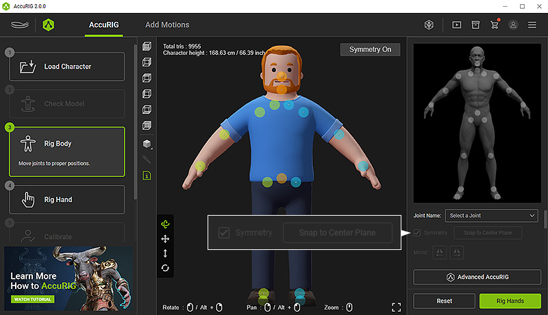

Force Symmetry
In the Check Model step, you can activate the Force Symmetry checkbox for a symmetrical model to accelerate the positioning of the joints.
  • In the Rig Body step:
    • The Symmetry feature is activated but disabled (grayed out).
    • The head, neck and pelvis joints will be locked to the center plane and the Snap to Center Plane button will be disabled.
