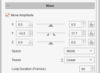

- In the Wave section, activate Move Amplitude and increase the range
in Y-axis to automate a floaty motion.

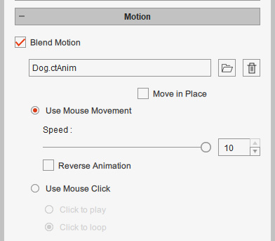

- Blend a custom animation for puppetry by
importing a
sequence animation in the Motion section.

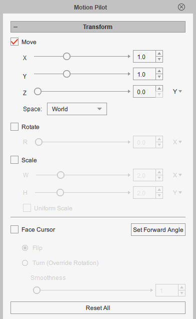

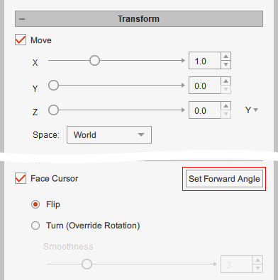

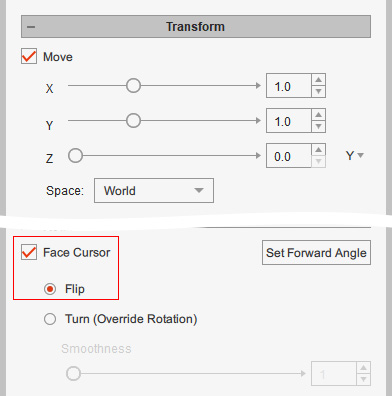

- Stop previewing and scroll back up to the Transform section and activate the Face Cursor checkbox. Choose the Flip radio button.
** By default, when you move mouse cursor leftward, the object remains unchanged. When you move mouse rightward, then the object will be horizontally flipped.

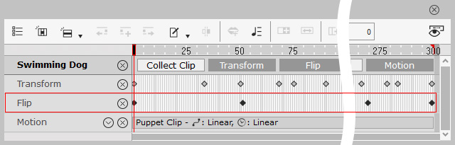

- Open the timeline and click the Transform, Flip and Motion buttons. As you can see the not only the Transform and Motion tracks are filled up with keys and clip, the Flip track also stores the flipping keys as well.

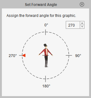

For Right-facing Objects
If the object in the scene is facing to the right, then you must the Set Forward Angle attribute to have the object move and flip correctly.
- Create an object that is facing right.
- Adjust the settings as described above.
- Click the Preview button and press the
Spacebar to start previewing. The object will move backward.

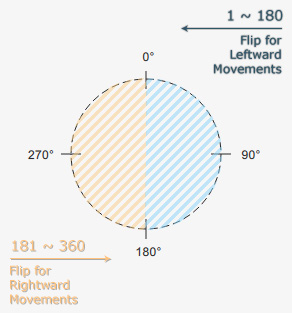

By default, the object can only be flipped horizontally when the cursor moves rightward.
- To solve this problem, click on Motion Pilot Transform
Set Forward Angle.
- The Set Forward Angle panel will apppear. There are three ways
to set the foward angle:
- Drag the red triangle around the circle.
- Type in the numeric field.
- Click on the numbers directly.
- Set the angle for the object. In this case, 1-180.
- 1
to 180 degrees:
- Move leftward --> Flip the object horizontally.
- Move rightward --> Remains object's original look.
- 181
to 360 degrees:
- Move leftward --> Remains object's original look.
- Move rightward --> Flip the object horizontally.
