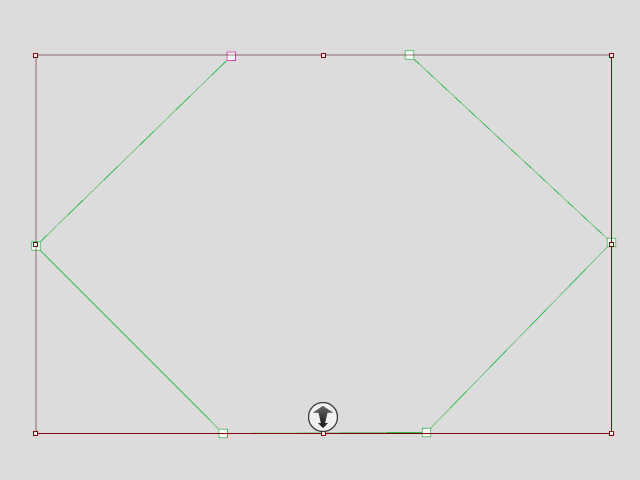

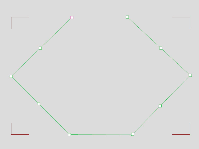

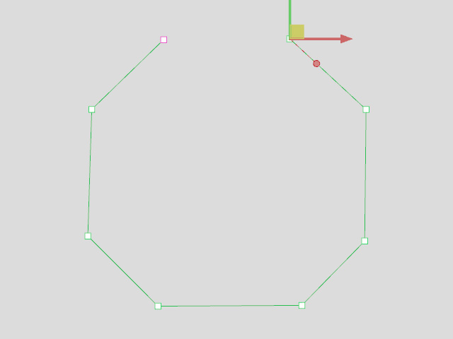

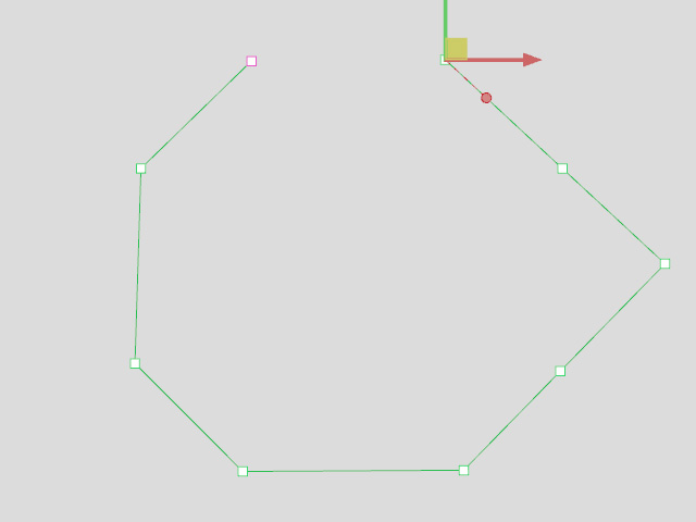

After a custom path is created, you are allowed to edit the path including adding or deleting anchor points, relocating anchor points and reshaping the path.
  1. Make sure the path for editing is selected.
  2. Start the path-editing mode.

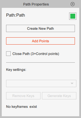

  3. Click the Add Points button in the Path Properties panel.
  4. Click on a specific spot on the path to add a new anchor point.
    Repeat the same step in accordance with your ideal design.
  5. Click the Add Points button again or press the ESC key to exit the path-editing mode.

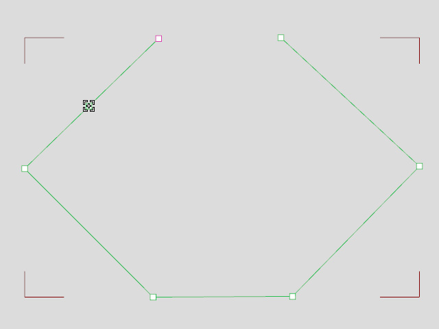

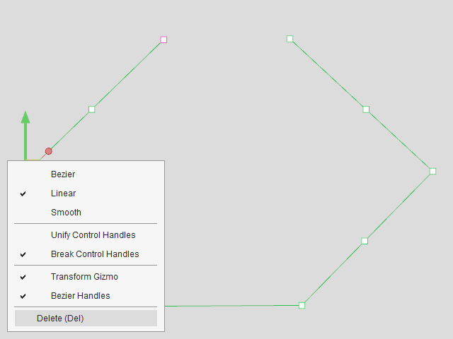

  6. Make sure the Path Properties panel is still open and click on the anchor point you want to delete.
  7. Delete the anchor point by pressing the Delete key or by using the Delete (del) command in the right-click context menu.
  8. The anchor point will be removed from the path.
    Repeat the aforementioned steps until the path is refined.
