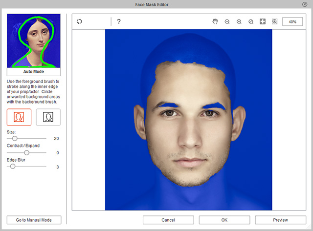

When your source image contains a simple background area with similar color or when the contours of the character are not complicated, you can use the Auto Mode to quickly define the mask for the background area. This mode is suitable for characters with sharp and clear contour edges because Cartoon Animator can quickly auto-masks areas according to the edges.

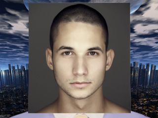

Before you add mask, you need to create an head from an image. After the head is generated, it is by default without a mask. Therefore, even if you replace the background, the original background of the image still conceals the custom background of the project.

The background of the original image conceals the custom background.
