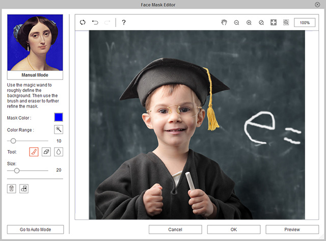

- Click the Mask Editor button at the tool bar to access the Mask Editor panel.
If you are in Auto Mode, then click the Go to Manual Mode
button to switch to Manual Mode.
- The mask added in Auto Mode will be brought to Manual Mode.
- Optionally click the Delete button to remove the entire mask.

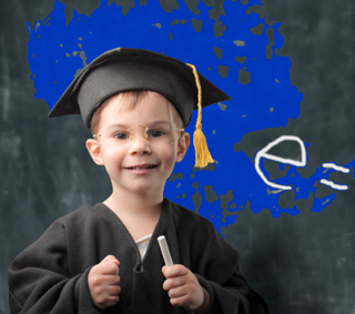

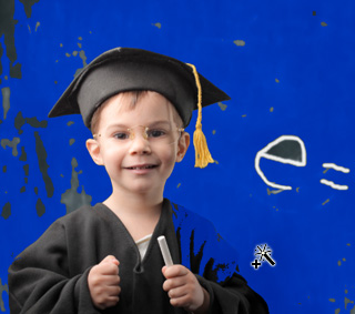

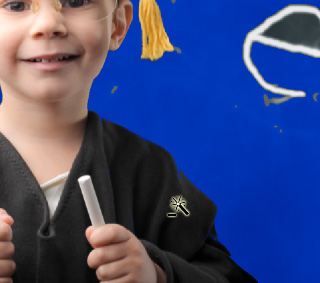

Press down the Color Range button and then click on the image to fill similarly colored areas with a mask.
- Areas with similar colors will also be masked.
- The similarity is determined by the Tolerance value.
Hold the Shift key and click on another area of the image to include more colors.
Hold the Alt key and pick an area of the image to exclude that color and other similar shades.

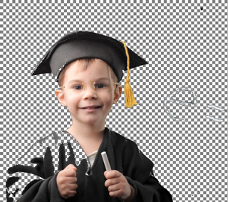

Click the Preview button to check out the mask result.
- You are able to use the Brush Tools afterwards for further modifications to the mask.
Click the OK button if you are satisfied with the mask result.

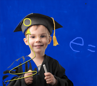

To modify the mask details, you can use the Brush Tools.
- Press down the Brush button in the Brush Tools section.
Draw strokes on the image to determine the masked area.

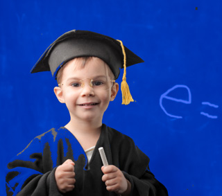

Press down the Eraser button and paint on the image to correct the
excess areas of the mask.
Remove the body and the neck in the same manner.

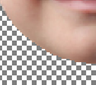

Press down the Blur button and paint on the edges of the mask to smooth the jagged
ones.
Jagged edges
Use the blur tool to remove the jaggy edges
