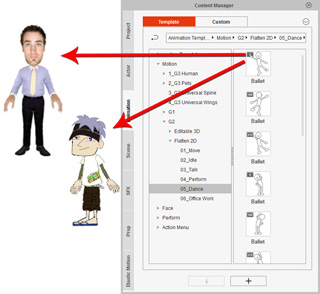

The easiest way to have a character move is to apply templates from the Content Manager.
To do this, simply go to the Animation tab in the Content Manager.
( Watch Tutorial - Intro to Motion Types )
You may apply body motions from the templates found in the library list:
- Motion
- Perform
- Action Menu
- Select a character.
Double-click on the desired template (or drag and drop the template onto the character) from the Motion or Perform library.
The character will then act out the animation.
