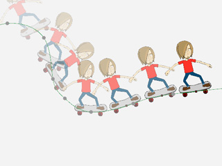

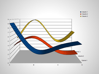

Not only can you quick capture still PNG files and paste them into external application software, but you can also directly import gif animations to give your documents a more attractive and unique look. You may also include multiple objects in a gif animation. Take Saul and his skateboard for example.
Create a simple document, in this case, the Microsoft PowerPoint

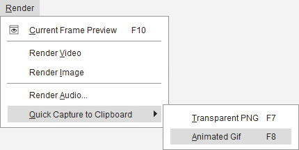

Open Cartoon Animator and create your own unique animation.
Select every object that you want to quickly capture.
Execute Render >> Quick Capture to Clipboard
>> Animated Gif.
(Shortcut: F8)

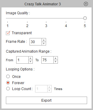

Set the parameters in the panel and click the Export
button at the bottom of this panel.
- Transparent: If you want to export a GIF Animation with alpha channel information, then activate this box.
- Looping Options: These three radio buttons determine the looping times of the GIF Animation.

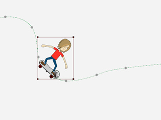

When you want to quick-export GIF animations, you are allowed to select single or multiple objects. Check out the following illustrations:

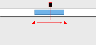

*Please note that the length is determined by the mark-in/mark-out flags that are auto-placed according to the Objects being Selected, the Motion or Animation Clips of them and the Play Head Position.

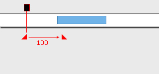

- Single object (with motion or animation) selected:

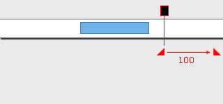

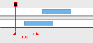

If no clip spans the play head, then 100 frames starting from the play head will be exported.

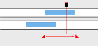

If a clip spans the play head, then the export range automatically changes to the same length as the clip.
If no clip spans the play head, then 100 frames starting from the current frame will be exported.

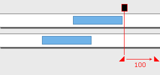

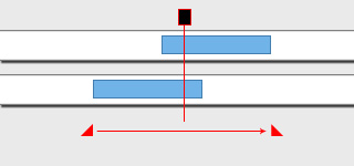

- Multiple objects (with motion or animation) selected:
If no clips span the play head, then 100 frames starting from the current frame will be exported.
If only one clip spans the play head, then the export range automatically changes to the same length as the clip.

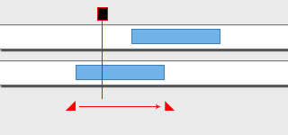

If multiple clips span the play head, then the export range automatically changes to accommodate the length of both clips combined.
If only one clip spans the play head, then the export range automatically changes to the same length as that clip.
- Please note that the quick-export range is automatically determined, however you are able to drag the mark-in/mark-out flags to manually change the length.

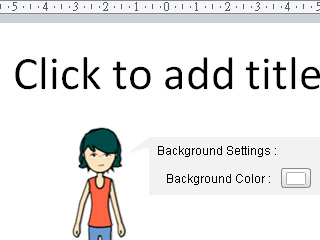

If you choose to render a transparent animated GIF file with alpha channel information,
when exporting the animation data, Cartoon Animator will use the project background color for calculation of edge anti-aliasing.
Therefore, make sure the project background color matches your target background to get the best edge quality.

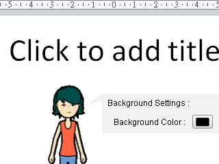

Before capturing your animation clip, click the Project Settings button on the play bar to
select a suitable Background Color in order to export an animated GIF that will best adapt to your background color.

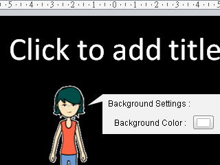

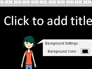

The background color of the project is white by default, and it may not fit in well with various situations. For example, a white background color will produce great results on a document with a white background, but may produce some artifacts along the edge of a black document, and vice versa.
A white Background Color works fine on a white background document, but it may present an unwanted white outline on a black one. |
A black Background Color fits well on a document with a black background, but it may produce a thicker edge on a document with white background. |
