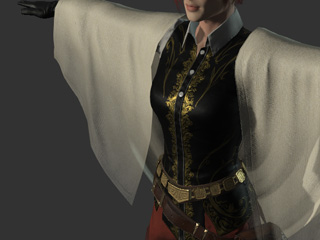

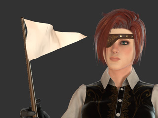

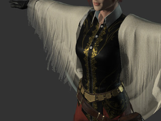

Character Creator provides Alpha Threshold settings for objects with Opacity textures. When you apply a grayscale image to the opacity channel, you may encounter some issues with earlier version of Character Creator. However, with the Alpha Threshold setting, these artifacts can be removed.
The artifacts caused by grayscale opacity texture
Fixed as the Alpha Threshold is activated
Alpha Threshold uses the opacity texture to trim accessories. Shadows will then be altered as the accessory changes look. Although the shadow results may look the same as the Shadow Threshold does, the accessory will be trimmed with the Alpha Threshold.

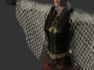

  • If the accessory contains no semi-transparent part, such as a chicken wire or fence, then you can enable the Alpha Threshold and adjust the value to skip calculating the semi-transparent parts.
    Black and white opacity image
    Alpha Threshold = On
  • This method increases the playback speed and performance.

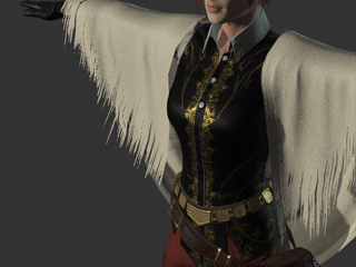

Fixing Undesired Edge Lines from Objects
  • When you use the Opacity channel to produce a partial transparent object, then you may find edges around the object.
    Alpha Threshold = Off
  • By activating the Alpha Threshold setting and adjust the slider, you may then eliminate these annoying edges.

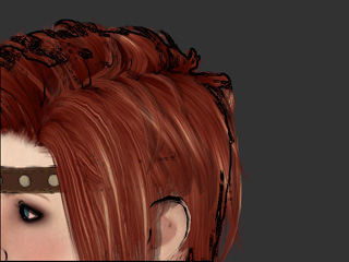

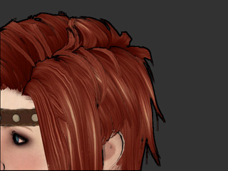

Correcting Character's Hair for Toon Shader, and NPR Post Effect
  • Each character's hair contains Opacity textures, which may cause incorrect Toon Shader or NPR results. By activating the Alpha Threshold box of the hair, the visual artifacts can be removed.
