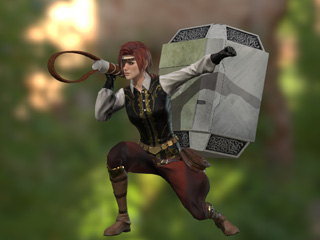

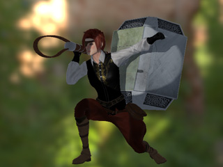

In Character Creator, only the Directional light and Spotlight are capable of generating shadows; while the Point Light, Image Base Lighting and Ambient Light are not.
  • Activate the Shadow option under the Shadow Map tab in the Visual Settings panel to set the shadow effect.
    Shadow from Directional Light
    Shadow from Spotlight
